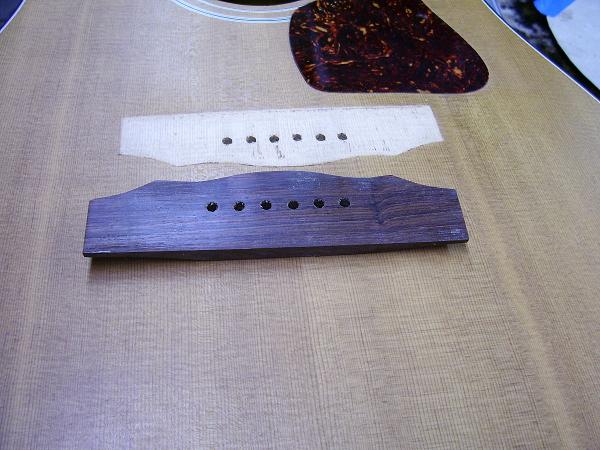

Can I reglue a rosewood bridge with hide glue that was previosly glued with PVA glue? I've scraped off the PVA but do I need to remove some of the wood to make sure all of the PVA is gone? Or is there a solvent I can use to clean?

You can use hide glue once all surfaces have been cleared of PVA, Plain old white glue PVA (Polyvinyl acetates). Because it's water base it would have penetrated the wood surfaces. However, I see no reason why HG couldn't be used. I wouldn't remove much wood just scrape off the old PVA, sand lightly to expose the wood and glue with HG.

I'll be ordering the de glue goo. After Googling it, it looks like the right thing to do. Get rid of all that residual glue left in the nooks and crannies. I think I should use hide glue now, but I'd like to hear some other opinions....
Here's a pic:
